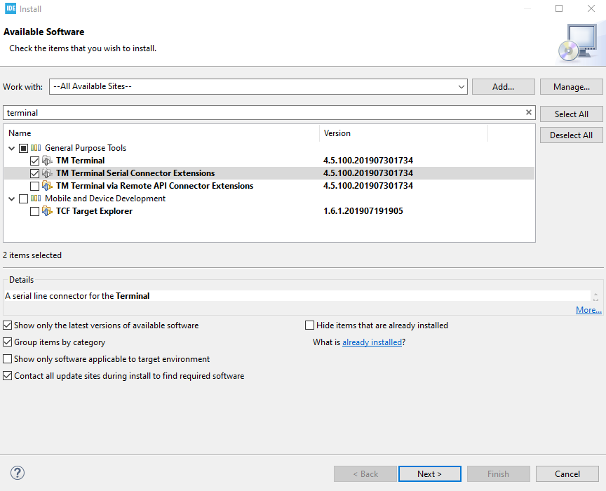

  1. Go to menu Help -> Install New Software
  2. Select Work with -> All available sites
  3. In the search box type "terminal"
  4. When search is finished select "TM Terminal" and "TM Terminal Serial Extensions" and install them.

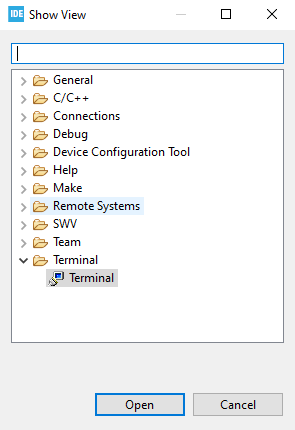

  7. From menu Window -> Show View -> Other select "Terminal"
  9. Terminal window should appear in IDE.

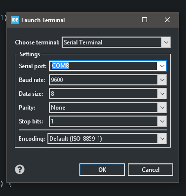

  10. Click Open Terminal icon (or Shift+Alt+Ctrl+T) and set up your connection parameters.

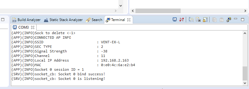

  11. This is the result in my case:

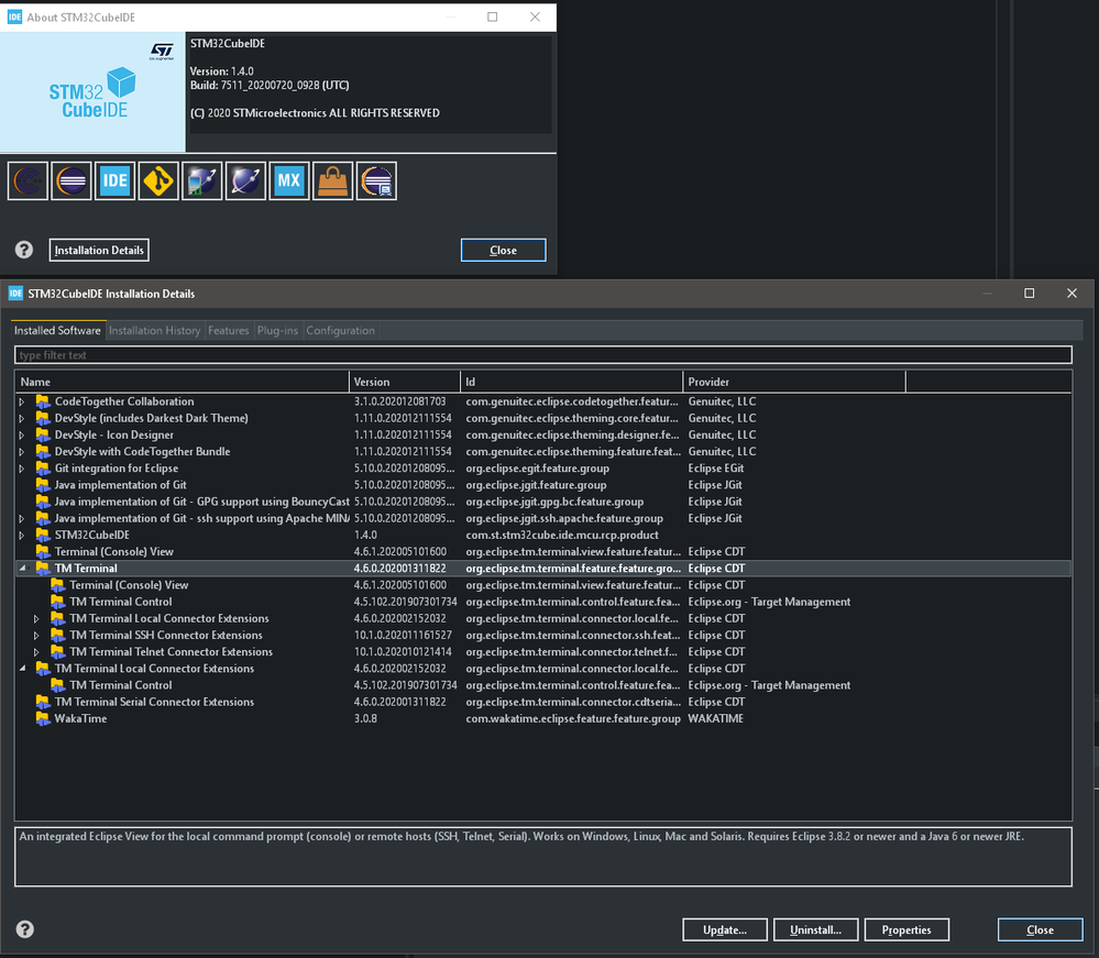

RKyzn.1
https://www.eclipse.org/setups/marketplace/?id=1687099
https://download.eclipse.org/tools/cdt/releases/9.11
help>install new software
When installing, it prompts you to immediately update, do not do this.IDE Version 1.2 1.3 1.4
version 1.51 no check,
on 1.5.1 crash is possible, check in the sandbox.
