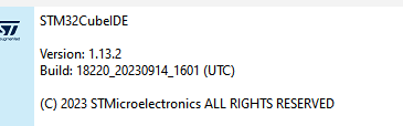

I am working with what I think is the latest STM cubeMX:

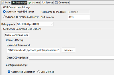

My debug settings are this:
And it -very specifically- happens when stepping in certain parts of the code. Presumably GDB tries to read some variable that it cannot access, or tries to disassemble some code, Idk, but in any case, the debugger fully quites

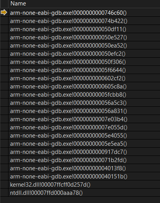

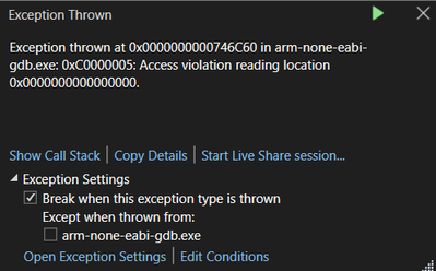

- Attached to arm-none-eabi-gdb.exe through visual studio and checked for execeptions:
GDB indeed crashes
I have no symbol information of the gdb build. But it's clear that the shipped GDB has issues, .. and crashes when stepping through certain lines of code!
Just to be clear, this is the version that cubeMX shipped, and has the issue:
C:\ST\STM32CubeIDE_1.13.2\STM32CubeIDE\plugins\com.st.stm32cube.ide.mcu.externaltools.gnu-tools-for-stm32.11.3.rel1.win32_1.1.1.202309131626\tools\bin\arm-none-eabi-gdb.exe --version
GNU gdb (GNU Tools for STM32 11.3.rel1.20230912-1600) 12.1.90.20220802-git
I ended up replacing C:\ST\STM32CubeIDE_1.13.2\STM32CubeIDE\plugins\com.st.stm32cube.ide.mcu.externaltools.gnu-tools-for-stm32.11.3.rel1.win32_1.1.1.202309131626\tools\bin\arm-none-eabi-gdb.exe --version with the one from https://developer.arm.com/downloads/-/gnu-rm (gcc-arm-none-eabi-10.3-2021.10-win32.exe) and the crashes went away ...
