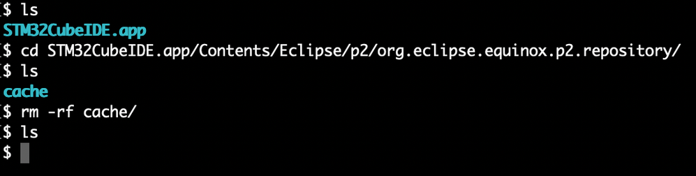

Did you tried to apply the workaround, aiming to cleanup the updater cache, already shared on the Forum?
  1. Stop STM32CubeIDE
  2. Remove STM32CubeIDE.app/Contents/Eclipse/p2/org.eclipse.equinox.p2.repository/cache
  3. Restart STM32CubeIDE and retry (Help > Check for Updates)

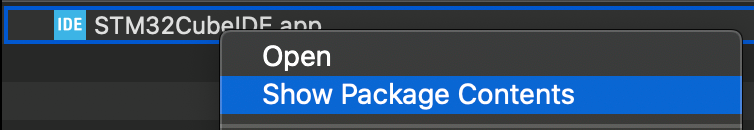

Hi Julien, no I didn't try that already. I did look before asking but I didn't see the post you refer to.
I closed CubeIDE and looked for STM32CubeIDE.app which I found in Applications (makes sense!). I cannot open it though to navigate further to STM32CubeIDE.app/Contents, if I open it it just starts the app. So I don't understand your instruction number 2.

Julien D
Indeed, to access deeper into an .app you either have to do it thanks to "Right click > Show Package Contents" or using a Terminal.
Not fully compliant with Big Sur means that you might face some troubles. Anyway we don't expect more issues with 1.6.1 than you could already have with 1.5.1. Both versions are based on the same Eclipse platform.
