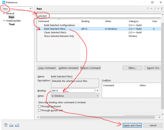

I would like to asign e.g. 'alt+x' to functionality to compile a file open in editor.
How to do that ?

Window > Preferences > [type 'keys'] > [type 'selected']
Click field 'Binding' and press desired keys combo.
