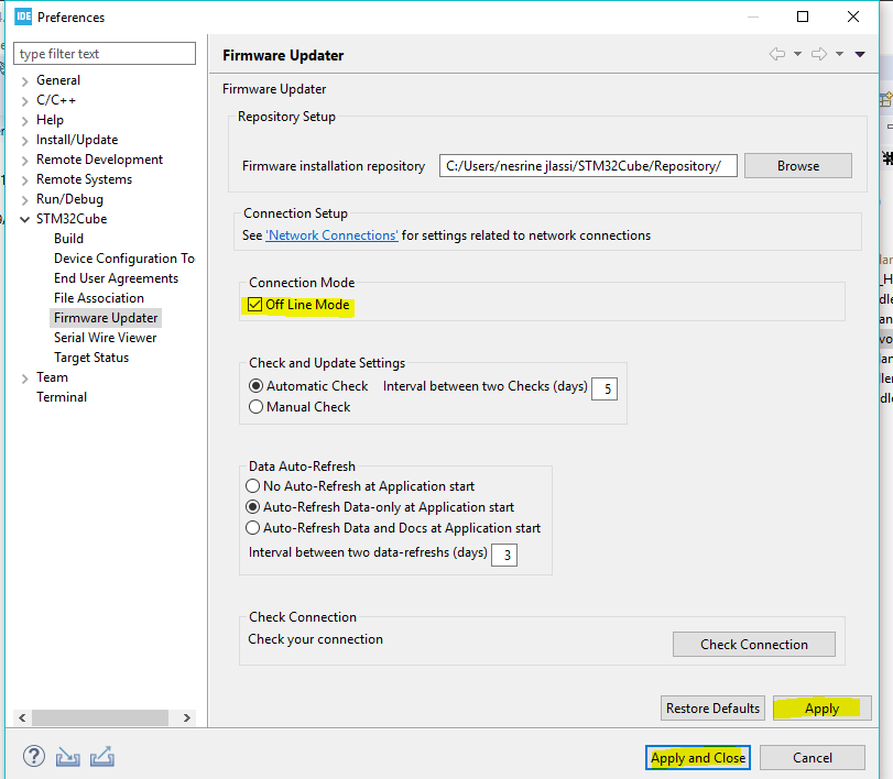

Hello @spica lai​
You have to do this following step:
- Start CubeIDE.
- Click Help the select Manage Embedded Software Packages .
- It cames out a dialog .
- Choose yes ==> it comes out some settings of CubeIDE
- Please apply off line Mode as attachment.
- Click Apply and Close
Best regards,
Nesrine
‎2020-04-15 5:14 PM
thx a lot for your reply.
I have done want you have said.
however, when I clicked Embedded Software Package Manager again, nothing came out. The manager dialog doesnot come out.

‎2020-04-16 2:27 AM
Hi @spica lai​
I tested the same scenario: I didn't connect internet then i start CubeIDE (open CubeIDE before internet is connected), I can open Manage Embedded Software Package normally.
Please try to reinstall the CubeIDE, then tell me if the problem still exists.
