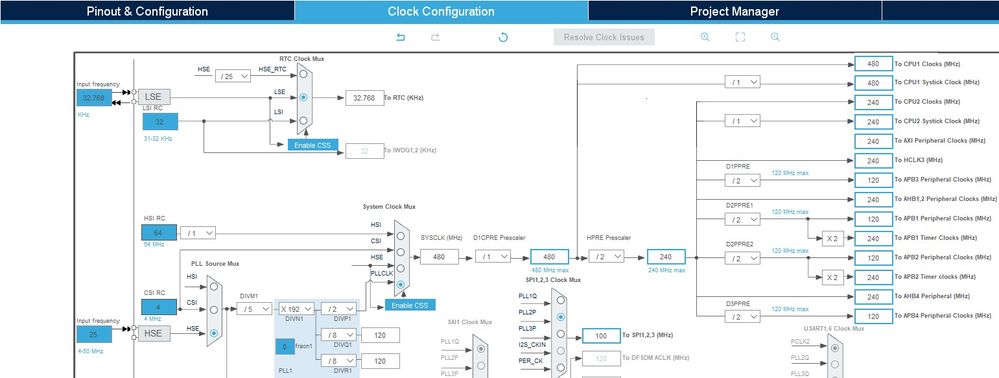

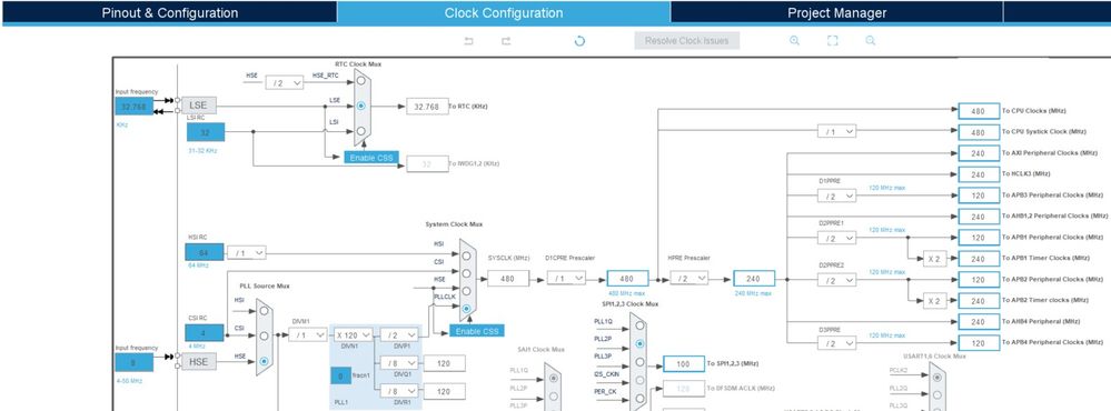

Hi Tesla DeLorean, here are two snips from the clock config.
This is the H743:
And the H745:
The main difference I can see is the HSE crystal being different between these two boards which requires adjusting the PLLs differently to achieve the same clock speeds. I did attempt using the CSI and HSI input to the PLLs and found it to be unstable when setting the sysclk up to 480.

Looking for the why, I've verified the PLL values are configured as seen in the graphical clock tool.
H743:

And H745:
