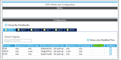

Hi
Im a bit new. I'm following a tutorial and i cant find the SPI_ICS like the guy on the video on the picture did.
Its a STM32L432KBU
Tutorial pic:
My STM32:

‎2025-05-02 3:16 AM
Hello @siyar ,
I suggest that you take a look at UM1718 section 4.5.12 GPIO configuration window.
Under User Label, you can change the default name (such as GPIO_input) into a user defined name.
The Pinout view is updated accordingly.
Thanks.
Mahmoud
