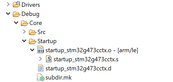

Can't find a source file at .../Core/Startup/startup_stm32g473cctx.s
TMich.1
How do I fix this? when i look into my folders the file is not there
6 REPLIES 6
Rim LANDOLSI
Hello @TMich.1​ ,
Thank you for posting this issue.
Is this from a created STM32 project inside CubeIDE itself?
What's the path to the workspace? Do you use any non-ascii characters or spaces anywhere?
Thanks,
Rim
yes it is created in ide itself. C:\Users\PC-SEVON\Documents\SCHOOL\OneDrive - KU Leuven\stm32\stm32g473. I'm not aware of any non-ascii characters, but the onedrive has two spaces in it's name. but I can see the location in the menu on the left, but not in my folders, and neither can the program
Could also be a "virtual" directory
Do you get the same error if you copy/clone this into a REAL directory on the hard drive ?
To find a real location of any file in Eclipse project, open its properties and look on the Resource tab. It shows the actual resolved file path.
Rim LANDOLSI
Eclipse is not able to build a project correctly if it is installed in a directory where there are spaces in the path.
Try to create a valid workspace path.
thank you, it doesn't give me the error anymore
