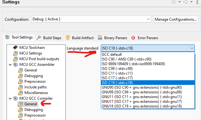

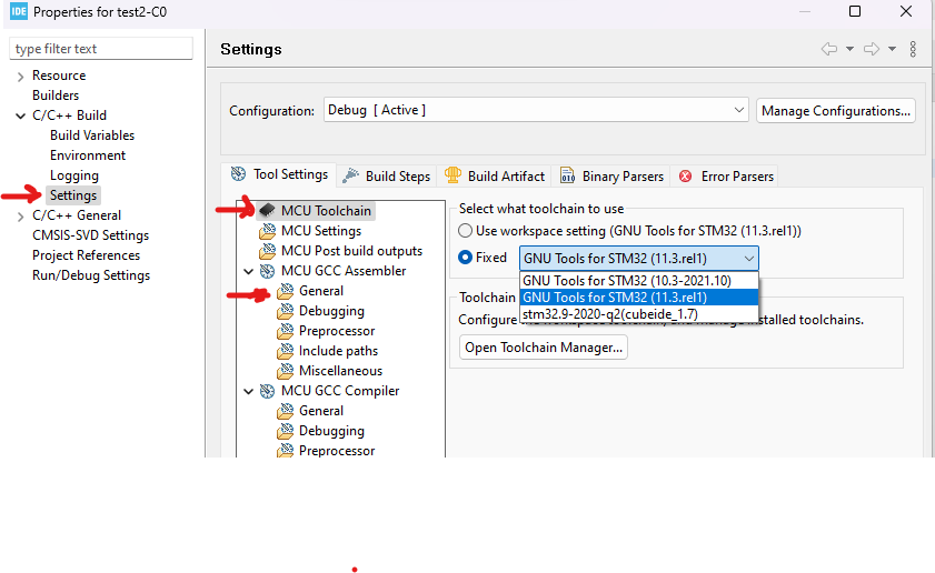

How inline functions fail for you?
There is no such thing as "nano compiler". What is the toolchain version in use, and which C standard level?
Robmar
Senior III
Sorry, that should have been the assert macro, and nano.specs Runtime library.
Version: 1.12.1 doesn´t show Language standards under general, the interface is different.
I had a look for this but could not see it, there is only two options under the MCU settings, Standard C or nano.specs runtime.
Toolchain is set to 10.3-2021.10
