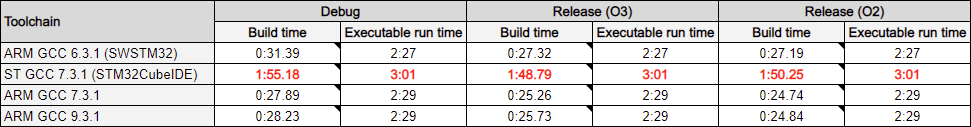

I am preparing for migration from SWSTM32 V2.4 (GCC 6.3.1) to STM32CubeIDE V1.4 (GCC 7.3.1).
During testing, I have noticed very significant performance issues in both compile time and generated executable run time. Please see the attached table for my test results.
All tests were done using CMake and changing the compiler path, so there is no effect of different IDEs.
NOTE: I was not able to test the generic ARM toolchain bundled with STM32CubeIDE, due to it not being able to find a header <bits/c++config.h>. I, therefore, downloaded GCC 7.3.1 form ARM for this comparison.
Run times are in seconds.
Best answer by Armandas
I think I got down to the bottom of this.
I was able to get the build time down to ~42 seconds, by making all the include paths absolute and removing almost all -I include path parameters from GCC build commands. I guess the long path support overhead is increasing with each include parameter.
By the way, the ARM GCC build time went down to about 20 seconds.

I re-took the GCC 7.3.1 tests with the parallel build disabled and got the following results:
ARM GCC 7.3.1: 1:48.07
ST GCC 7.3.1: 8:28.49
The difference is staggering...

Hi @Armandas​,
@Ozone​, is right in that there are tools that in many cases provide better code size and execution speed performance than GCC in general.
What is puzzling is the extremely poor build time performance your benchmark shows. We already know since before that GNU Tools for STM32 is about ~30 slower the GCC for ARM on Windows. The reason for the anticipated ~30% slow-down is that our toolchain supports long paths (one of the patches not part of GCC for ARM). This has been a huge source of problems in the past since many example projects have "deep folder hierarchies" and customers are allowed to place the Cube repository anywhere... But your trials are showing ~300%. That is not expected.
I assume this is on Windows only? If you ran on MacOS/Linux the compile time should be ~identical between GNU Tools for STM32 and GCC for ARM.
We have made a fix for make/busybox to try to resolve the parts of the "30% slow-down", but there are still remaining fixes to be added in other places of the toolchain code.
Could you try importing instead some large example project from the CubeFW packages and build that and compare build times ARM vs ST? Do you always get this result? Maybe we could compare the same example projects on two different environments to see if we see the same result?!
Your code execution speed result also looks on the poor side. Impossible to say why without looking at your code...
Thanks for providing your feedback!

Thank you for the answer. I have tried a few things as suggested.
Building the above project on a Linux machine, I got identical results with ST GCC 7.3.1 and ARM GCC 7.3.1.
Back on Windows, I tried to build some different projects:
  • Another (smaller) project:
    • ST GCC: 31 s
    • ARM GCC: 12 s
  • TouchGFX Demonstration from CubeFW:
    • ST GCC: 65 s
    • ARM GCC: 42 s
The TouchGFX example does not appear to be impacted as much as our internal projects.
Armandas
ArmandasAuthorBest answer
September 1, 2020

mattias norlander
September 2, 2020
CubeIDE does not use any Unix emulation.
But when using relative paths they have first to be converted into absolute paths before it can be expressed as an UNC path. So relative paths should introduce some delay. GCC Arm does not require UNC paths since it does not support long paths. So the UNC conversion step in theory should introduce some delay on the GNU Tools for STM32 vs GCC Arm.
Nevertheless the original results presented above is way worse then our benchmarks.
Regarding "execution time on target" GNU Tools for STM32 vs GCC Arm, we do expect a little bit slower execution speed in the ST toolchain because of:
  • GNU Tools for STM32 newlib standard library is optimized for size -Os, regardless of the project optimization level
  • GNU Tools for STM32 newlib nano library is optimized for size -Os, ...
  • GCC Arm newlib standard library is optimized for size -O2, ...
  • GCC Arm newlib nano library is optimized for size -Os, ...
  • Additionally GNU Tools for STM32 sets more defines for both newlib variants to improve code and RAM size
And as we know smaller code (fewer instructions) tend to effect execution speed in a negative way.
If this makes up for the full difference? ... Hard to tell...
