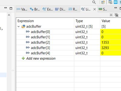

Now, I have another question.. Instead of circular dma, I just did it normal dma.. and I call the ADC_Receive_DMA every 2 secs (from my main loop). I have voltage supplied into 2 channels out of 5. Now at every interrupt call, the value of the DMA buffer looks funny... The position of the channel 8 and 9 position keeps changing in the DMA buffer.. Below are 2 screenshots from the live expression..
Here is the adc related code..
uint32_t adcBuffer[5] = { 0 }; //We are reading 5 channels void HAL_ADC_ConvCpltCallback(ADC_HandleTypeDef *hadc) { if(hadc->Instance == ADC1){ //Doing nothing for now } } uint8_t ADC_Read(ADC_HandleTypeDef *hadc) { if(HAL_ADC_Start_DMA(hadc, adcBuffer, 5) == HAL_OK){ return 1; } return 0; }
The ADC_Read() is called from main loop every 2 seconds..
