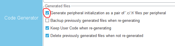

I have a project on Nucleo board with STM32U575ZIT6Q. I'm using STM32CubeIDE.
My ADC worked fine until i did this:
After migration HAL_ADC_Start function returns error.
When I generate code I use this setting:
What is wierd, is that if I unselect this box, and generate code then ADC starts to work again!
Since I need to have those files separate I have to use previous Cube version.
Is there something I need to do or this is a SW bug?
Thanks.

‎2024-07-08 1:37 AM - edited ‎2024-07-08 6:21 AM
Found the differences:
main() is the same and calls all functions in same order
both projects generate a warning about the SMPS when clicking generate, instructions unclear how to solve this
MMTAppRegionsCount differers, the "ok" has 0 regions enabled and the "nok" version has 3 regions enabled in the ioc file, but I see no difference in generated code
ProjectManager.CoupleFile=false in the ok version, true in not ok
MX_ADC4_Init() is the same
MX_GPIO_Init() is the same
MX_ICACHE_Init() is the same
HAL_ADC_MspInit() is the same
HAL_ADC_MspDeInit() is the same
HAL_MspInit() DIFFERS!
Line "HAL_PWREx_EnableVddA();" is not generated!
To me this is a bug. You can add HAL_PWREx_EnableVddA() in the user code section and that should fix it. Please let me know if that works.
ST needs to be aware of this. Please add bug-report tag to your start post.

‎2024-07-09 2:28 AM
Hello @unsigned_char_array
Concerning the missing HAL_PWREx_EnableVddA() , I confirm that this is a bug that has been raised to our dev team and this will be fixed as soon as possible .
Internal ticket number:143431 (This is an internal tracking number and is not accessible or usable by customers).
I will keep you posted with updates.
THX
Ghofrane
‎2024-07-09 5:26 AM
Adding HAL_PWREx_EnableVddA() works!
Thank you for investigating.
