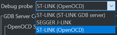

I've been debugging a custom designed board that has an FT4232 USB IC on it with a JTAG interface. STM32Cube IDE up to 1.3.1 could successfully debug this through openocd. Version 1.4.0 wants to force firmware verification so I can no longer program and debug my board. How can I disable the ST-Link firmware check?

The point is I do not have an ST-LINK device. And the new IDE insists on verifying the firmware of my non-existent ST-LINK device. So it fails. I'm using an FTDI USB chip (FT4232H) that can provide a JTAG interface to my STM32H753 using OpenOCD. In the debug configuration, you can choose to have one of the debug probes as shown here:0693W000003BaE8QAK.pngWe need another option, ST. One that is a generic OpenOCD probe, not expecting a real ST-LINK device, one that works like it used to work in versions up to 1.3.1.

Solution then is to rely on common native Eclipse debug configuration I guess.
According 1.4.0 release notes sounds some update in this area. Available on www.st.com: https://www.st.com/content/st_com/en/products/development-tools/software-development-tools/stm32-software-development-tools/stm32-ides/stm32cubeide.html#resource
vincent_grenet
Starting right now a 1.4.1 STM32CubeIDE release is available to you.
Such minor 1.4.1 patch (some Kbytes) is solving issue reported by this topic.
