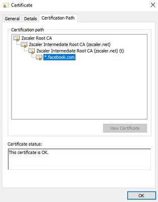

Julien D
AFAIR there should be at least 2 certificates, the Zscaler Root CA and the Zscaler Intermediate Root CA, as shown in this screenshot (again picked on the Internet):

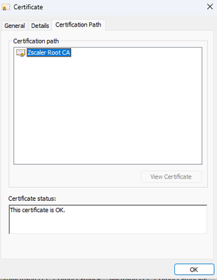

Jagan1
only one is there.

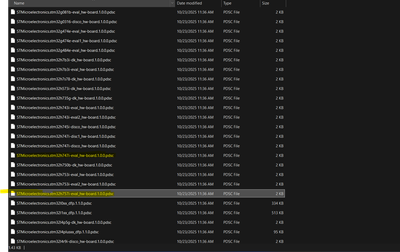

Jagan1
these packs available looks like is this correct?
only one is there.
 I wonder from where you get this screenshot. If from the Windows cert manager then I think it is expected since you only view the selected certificate. But if you get the certificate by clicking on the lock from a browser you may get more certificates in the chain.
Packs are installed under %AppData%/Local/stm32cube/packs/STMicroelectronics/.
