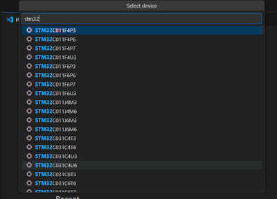

Hi I am trying to configure a project in Vs code.
1) Created/Generated a project using STM32CubeMX.
2) in vs code extensions added
3) by using open folder latest created project loaded
4) on pop-up Debug option selected
5) Then when it comes to device selection unable to find STM32H7 Series, eval board numbers in the list.

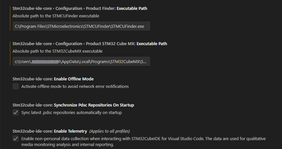

Note : STMCUFinder path, cubemx paths configured . please check below images

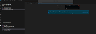

Oct 24, 2025 12:46 PM UTC
@Jagan1
Please let's skip this quick pick and focus on the red text field. Has any device completion appeared when you start typing STM32...?
If not, could you please try running the following command in the VSCode integrated terminal:
cube pack sync
Does the process complete successfully? If not, please share the trace.
Jagan1Author
Oct 24, 2025 12:53 PM UTC
Hi @vincent_grenet , Other boards/devices showing only STM32H series missing.
unable to sync also .

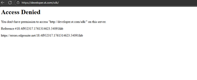

Jagan1Author
Oct 24, 2025 2:05 PM UTC
Julien D
Oct 24, 2025 2:12 PM UTC
Ok, it is denied but at least you have the lock meaning connection is secured, so you can proceed with the rest of my previous message.

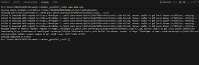

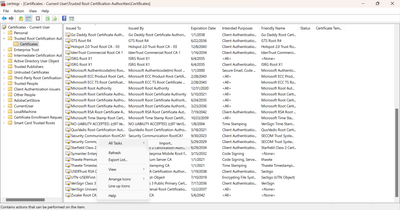

Oct 24, 2025 2:25 PM UTC
Hi, fallowed same steps, only one Zscaler is there in certmgr and exported, still same issue.
>> Restarted vs code
PS C:\Users\JNEKKALAPUDI\Documents\stm\test_gen\test5> setx NODE_EXTRA_CA_CERTS "C:\Users\JNEKKALAPUDI\Documents\stcertificate.cer"
SUCCESS: Specified value was saved.
PS C:\Users\JNEKKALAPUDI\Documents\stm\test_gen\test5> cube pack sync
Syncing metadata information C:/Users/JNEKKALAPUDI/AppData/Local/stm32cube/packs
Snapshot is already up to date
Syncing online metadata information C:/Users/JNEKKALAPUDI/AppData/Local/stm32cube/packs
Checking pidx https://developer.st.com/st-pack-server/api/v1/pidx/STMicroelectronics.pidx... (1/1)
Failed to download with request to https://developer.st.com/st-pack-server/api/v1/pidx/STMicroelectronics.pidx failed, reason: unable to get local issuer certificate, retrying...
Maximum number of retries reached: request to https://developer.st.com/st-pack-server/api/v1/pidx/STMicroelectronics.pidx failed, reason: unable to get local issuer certificate
Downloading https://developer.st.com/st-pack-server/api/v1/pidx/STMicroelectronics.pidx failed: FetchError: request to https://developer.st.com/st-pack-server/api/v1/pidx/STMicroelectronics.pidx failed, reason: unable to get local issuer certificate (1/75)
Syncing completed in 0.964s
Julien D
Oct 24, 2025 2:35 PM UTC
AFAIR there should be at least 2 certificates, the Zscaler Root CA and the Zscaler Intermediate Root CA, as shown in this screenshot (again picked on the Internet):
Jagan1Author
Oct 24, 2025 2:44 PM UTC
only one is there.
Julien D
Oct 24, 2025 5:38 PM UTC
only one is there.
 I wonder from where you get this screenshot. If from the Windows cert manager then I think it is expected since you only view the selected certificate. But if you get the certificate by clicking on the lock from a browser you may get more certificates in the chain.
