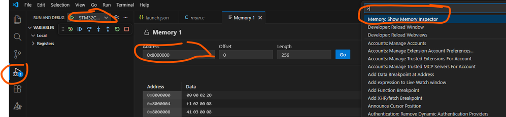

STM32CubeIDE for VS Code is there a memory window? like MDK Memory window
Cartu38 OpenDev
Lead III
@ShimiaoWang
See "show memory inspector" feature from command palette.
Only available if running debug session.
