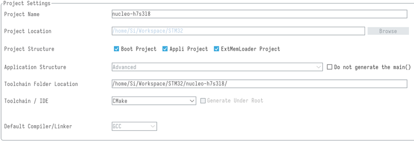

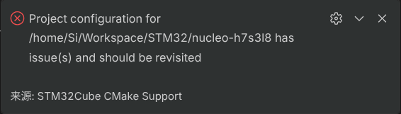

Just like the normal process, I generated the H7S3L8 project using CubeMX.nagelanping_0-1766825171070.png

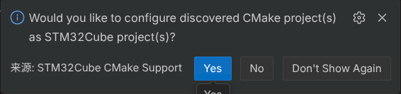

Then I opened the project folder with VS Code, and STM32 VS Code extension detected that it is an STM32 project.nagelanping_1-1766825355905.png

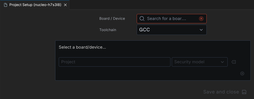

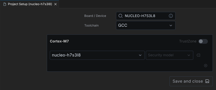

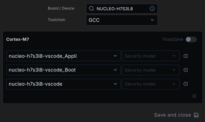

It required me to manually configure the specific model of the STM32. It seems that the CubeIDE for VS Code extension did not correctly recognize the model.nagelanping_3-1766825606824.pngSo I just chose the NUCLEO-H7S3L8.
But when I click the 'Save and close' button, it just shows the clicked animation effect, and then nothing happens. The extension still can't properly load the project and perform automated configuration.nagelanping_4-1766825889706.png
Why is this happening?
I am quite sure that other projects (such as STM32F401RCT6) can be properly recognized and loaded; moreover, if I manually go to 'Setup STM32Cube project(s)', the 'Save and close' button works normally for those projects.
It seems that only the NUCLEO-H7S3L8 or STM32H7XX series has this problem, or am I the only one experiencing it?
I speculate that this may be because the H7XX model project has three subproject folders: Boot, Appli and ExtMemLoader. And the extension is currently unable to properly load this type of project. So is there any solution?

@nagelanping

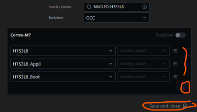

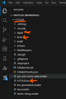

Device detection works for me:
You have then to explicit all projects to get setup completed
Myself I'm adding at once complete MX generated project root folder which is including them all
