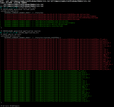

Also, one final point: neither the extension, nor STM32CubeIDE itself works correctly when HAL, CMSIS etc are provided via submodules. You can build the projects, sure, but any code generation will royally mess things up. Maybe allowing the developer to specify which folder contains the HAL or CMSIS headers is required?

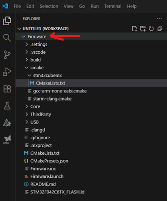

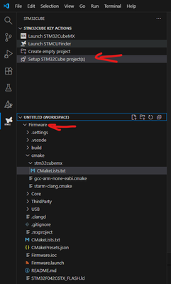

  • I've added "Firmware" folder to VSCode workspace (not your git repo root because not CMakelists.txt at root of)
Doing all such I'm build success and prior STM32CubeiDE for Visual Studio Code is able to act as expected.

Like explained, "cmake-test" branch is a scenario where the two projects, "Firmware" and the-still-unexisting "GUI" are independent in the sense that the developer would use VS Code's "CMake: Select Active Folder" command to change between the two. I provided it as a courtesy to @vincent_grenet in hopes that it might help them in choosing how to develop the extension further.
The key point of my entire post is to point out that the STM32Cube extension itself does not properly support a scenario where such "independence" exists. I am aware that declaring a VS Code workspace would solve the matter. Also, like shown in "cmake-test-in-root" (and also currently in "main") it is possible to utilize an alternative approach to make the extension work.

Now that I managed to get started with the "GUI" side of my project I have to say that workspaces with two separate folders is the only way forward for me.
The underlying reason, suprisingly, has nothing to do with the extension but more about CMake itself: it does not allow a setup where you use two different C++ compilers inside one CMakeLists.txt. Since the firmware portion is built by an ARM GCC compiler and the GUI portion uses x86_64 LLVM then I need to use two separate CMakeLists in two different folders.
The ordinary "CMake Tools" extension is able to handle this just fine but "STM32Cube CMake Support" extension throws fits when it encounters this situation.
