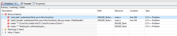

I am working on a project where I am using FreeRTOS. It was working fine but after adding a couple of more features there are strange errors.
It says that the particular variable doesn't exist but the variable is actually initialized in the same code/file.
Please help
Thanks
Rahul
see the code below: the error is

BaseType_t status;
extern TaskHandle_t next_task;
extern TaskHandle_t task2_handle;

Bob S
int main(void)
  /* USER CODE BEGIN 1 */
  TaskHandle_t task1_handle;
  TaskHandle_t task3_handle;
  TaskHandle_t button_handle;
  // more code that doesn't matter.....
You declare these ^^^^ variables as LOCAL to main().  There is no way to access them from other functions, not even with "extern" declarations.  Move these declarations outside main() to make them global variables.  Then remove the "extern" declarations in the other functions (not needed as long as those functions are in the same source file as the declarations).
