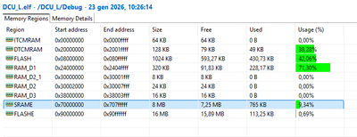

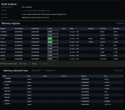

I tried to use the Build analyzer in VSCode, but there are some important allocations missing:
VSCode:
STM32CubeIDE (using *.elf file produced by VSCode):
This is probably because the VSCode plugin is using the *.map file while the STM32CubeIDE uses the *.elf file.
Is there any chance to have the same Analyzer in VSCode?

Hi @MHoll.2
Thanks for the suggestion already in the pipe for a later release

​@MHoll.2
The July update of STM32CubeIDE for Microsoft Visual Studio Code resolves this issue adding binary file processing as extra map file to get more data. Update the local setup to benefit from this improvement.
