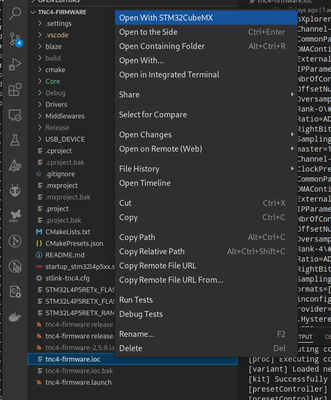

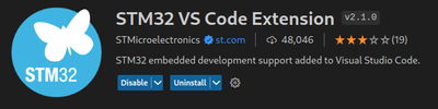

I am running VSCode on Fedora 39 with the latest STM32 VSCode extensions.

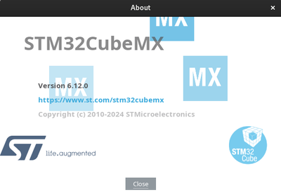

I am using STM32CubeMX 6.12.0.

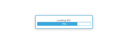

First, STM32CubeMX is not the default action when clicking on the IOC file. It is rather surprising that it is opened in a text editor in VSCode. However, the real problem is that when I right-click on the IOC file in VSCode and select "Open with STM32CubeMX", STM32CubeMX starts up, begins reading the IOC file, and just hangs, never completing the action. This is all I see:
The window is unresponsive. I cannot close it. I need to then manually find the Java process and kill -9 it to resume normal operations. If I start STM32CubeMX manually from the command-line, it works fine. I have verified that both are using the same JRE.
What is causing this and are there any work-arounds?

@Nawres GHARBI I updated the extension (and have restarted VS Code numerous times) and still see the same behavior. One new thing I did discover while testing the new extension it is that STM32CubeMX will complete loading if I exit VSCode (File|Exit) while it is stuck loading the IOC file.

I am running Fedora 39.
I am running STM32CubeMX 6.12.0.

  3. I should be clear that the path to CubeMX is saved, and it is used by STM32 VSCode extension to launch CubeMX to create a new project. It does not use this path when opening an existing IOC file (right-click, "Open With STM32CubeMX" using vscode-embedded.openWithStm32CubeMx). I do not know when the STM32 VSCode extension would use the CubeCLT path.
Looking at this more closely, this is coming from Microsoft's Embedded Tools Extension. The STM32 VS Code Extension provides no way to easily open an existing IOC file directly from the VSCode UI.
So, to be clear, the problem with STM32CubeMX hanging when launched from VSCode is occurring in Microsoft's Embedded Tools Extension, not in STM32 VSCode Extension.
