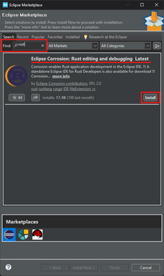

However, maybe I didn't express myself well. I would like to understand if there is an IDE that allows me to debug and compile Rust code for STM32 without ever using the prompt, just like with STM32CubeIde and the C language. I have seen online that JetBrains offers CLion and RustRover, but RustRover requires the prompt while CLion does not. Additionally, I have seen that it is possible to install a plugin directly on STM32CubeIde that allows me to debug and compile with Rust. Can you tell me more about this? Thank you very much.
‎2024-07-15 1:51 AM
Well if you want to stick to STM32CubeIDE, there is a Rust IDE made by Eclipse : Rust Corrosion. Since CubeIDE is base on the Eclipse framework, you can install Corrosion from the market place: Help > Eclipse Marketplace...
Then search "rust" and install it:
I've never used it but it looks like you can build and debug with it.
I let you try it out and see if it works for you.
