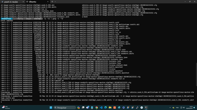

@JeanPhilippeR No for OpenSTLinux but for imx7d-pico and imx8mm-pico. Using Ubuntu 22.04 I do Kirkstone. Using Ubuntu 20.04 I do hardknott
@JeanPhilippeR
Please confirm above if the final result for stm32mp157 is correct?
If so, it seems that it only works in wsl2 where the result of the ifconfig command shows an IP number outside the internal network that would be something like 192.168.X.XXX
How the best way to build this result (ext4?) to device (in wsl2)?
