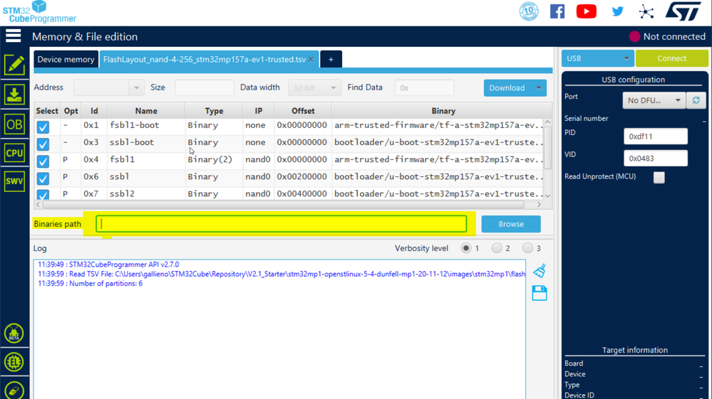

What does "Error: Please specify Binaries path" refer to as an error when attempting to program a device.
MDeac.1
System windows STM32MP157F-DK2 board. The binary I can load and the device connects but it throws the above error. I can find nowhere to set any path in the software.

Hi @MDeac.1​ ,
When opening the TSV to program your target an Binaries Path field appears.
I understand it's not well populated in your case.
Olivier

Okay thank you for the response. I do not get that binaries path where I can enter the data so let me look into it further.

The short answer and it really depends on the platform you are working on.
- the binaries issue is because you are not using Linux.
With the .tsv structure and no way to operate this development from a solely windows PC unless it has had VMWARE installed is just asking for lost work and cost. The Linux machine I currently have is solely for Android / Microchip development and that is the machine I would have to put it on and that is not up to much at this time. The mistake and I assumed incorrectly the development system would run on windows alone it does not.
The Linux machine is the true dependency here and mentioning windows is only to suggest a greater compatibility. I have ordered another ST development board because I want a straight forward compile / program environment without the complication of an alternative operating system in the middle and this board I shall discard as really not useful. I did use the cube IDE to create a binary/elf file but you need to fulfill all the other dependencies to even achieve any meaningful programming, requiring Linux, VMWARE etc. etc.
I have ordered a new simpler ST board to check what I feel will be the same issue as it is in the structure of what ST has designed for its system. If that works fine, if not I will skip over ST as I know what I want and ST will never be able too offer that because of the dependency structure.
Hi @MDeac.1​ ,
I understand your concern, please note that CubeProgrammer is fully supported on W10 (we use it daily).
CubeIDE is also working on W10 for Cortex-M4 Firmware development and debugging. Only Linux development related features are absent from W10.
I agree that Linux development require an Linux environment (dedicated or virtual machine such as VMWare, but other free virtual machine players should work), but this is also a Linux community choice as some environments/tools are not supported on W10.
Historically, Linux come from PC world, then go later to embedded systems, so we cannot blame that Linux people community target their tools for Linux PC.
I agree that working with an Ubuntu virtual machine is an addition complexity for the initial setup, but once this step achieved, it is handy (we use it daily as well as many of our customers).
Some virtual machine are free for non-commercial usage, apart maybe some additional PC resources (memory and disk).
In the future, the Linux toolsets might be supported on W10 thanks to WSL, but this is not completely the case today.
