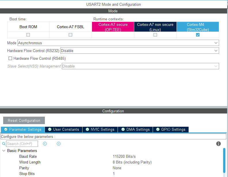

I have a STM32MP157A-EV1 board. I'm running it in the engineering boot mode and programming the Cortex-M4 directly through the STM32CubeIDE. At the moment, I do not use the Cortex-A7.
I would like to enable USART2 and use it through the ST-LINK to view the printf command that I do on the Cortex-M4.
What I did was enabling USART2 in STM32CubeMX :
I did not change any other configuration and simply regenerated the code. Then I used these functions:

USART2 is not connected externally on STM32MP157A-EV1 board (PD5 is NAND_NWE and PF4 is SDMMC3_D1). I assume you have a specific motherboard and you use an external STLINKV3, right ?
On regular EV1 board, embedded STLINK VCP is connected to UART4 (using some jumpers), or you could have access to USART3 on GPIO expansion (CN21).
For USART2, did you check (within code and/or debugger) that:
  • SystemClock_Config() is executed (which is under IS_ENGINEERING_BOOT_MODE condition) ?
  • USART clock is enabled ?
  • GPIOs AFMUX are correctly sets to right pins ?
Maybe first try to send characters using HAL_USART_Transmit() fonction instead of printf().

Yes just found out that USART2 was not connected externally sorry. I now use USART3 connected to the PIN PB10 and PB12 on the GPIO connector (CN21).
No I don't have a specific motheboard, I use the one that comes with evaluation kit (STM32MP15X-EVAL) and I use the integrated ST-Link v2.1.
I made progress, I used the UART_Receive_Transmit_Console example furnished by ST from the eval kit and it worked by connecting a USB TTL converter to GPIO pins PB10 and PB12.
Now I try to replicate the configuration through STM32CubeMX. I enabled USART3 and configured the ouput pins as PB10 and PB12 as in the example.
I then retested with the same code and it worked. I can now successfuly send UART through printf and then read the serial output through the GPIO pins. Thanks.
