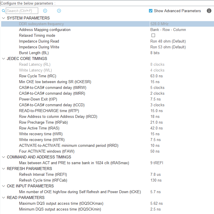

I do have some unexpected behaviour with the DDR Tuning tool as follows:
  • The DDR Test Suit can connect to the board and all tests are successful.
  • The DDR Tuning finds some parameters which are mostly consistent over multiple runs of the Tuning tool.
  • However, if I load the tuning parameters to the RAM, it just stops working and I get the error "Loading execution abnormally long, you must check and re-initialize the connection"
  • It doesn't work neither if recompile the BSP skiping RAM built-in calibration and use the tuning params.
I'm using the Winbond W97AH6NB / W97AH2NB RAM. The CubeMx RAM configuration looks like this:
My current questions:
  • How is it possible that I can boot up to Linux, run the UBoot and CubeMx RAM tests succesfully but using the tuning params doesn't work?
  • Do you see any possible missconfiguration that can cause this?
Regarding the relation with the DUF problem: it can be that the RAM is still not fully functional when the TF-A starts writing the layout on it with the programmer, and for this reason it gets corrupted.
Bests,
Moises

I suspect also an issue with the LPDDR2. Not expert enough to comment your values.
Please confirm you have a 100 ohms resistor between DDR_CLKP and CLKN (close to LPDDR pins). We recently discover that this info is missing in AN5031, but present in AN5122 and routing examples.
Btw, please double check the tf-a-serialboot.stm32 you are using is really using the same parameters you have in tf-a-trusted.stm32 (as you mention that you boot up Linux, so likely using this latest one).
As it seems you are using 800MHz without STPMIC1, please confirm your VDDCORE is set at 1.35V before going above 650MHz.
I see you are using Ecosystem V3.0, I encourage you to move to latest Ecosystem v3.1 which has (beside other updates) one specific update for LPDDR (not sure it is linked to your issues)
  • Enabling LPDDR2 / LPDDR3 PHY built-in read valid training (RVTRN)
Regards.

Moises Araya
Hi @PatrickF​ ,
We have tried a couple of things you suggested and I would like to update about the partial results:
  • I'm using TF-A out-of-the-box (no own recipe nor own defconfig). And in the machine config I set both CUBEMX_DTB_PATH_TFA and CUBEMX_DTB_PATH_TFA_SB to the same directory. So there shouldn't be any device tree or configuration difference between those two.
  • You are right, we have passive power supply but checked VDDCORE and it is at 1,37V without significant variations in the mV range (300MHz oscilloscope). DDR_VREF is also withing the accepted peak-to-peak noise of the Winbond RAM.
  • I updated our BSP to the Ecosystem V3.1 and got same results. I attach the logs again for comparison.
  • We do not have a 100Ohm resistor between DDR_CLKP and DDR_CLKN but unfortunately it would mean to layout and order again our PCBs to correct this impedance termination on the clock.
  • Reviewing some of the application notes we discovered that we don't meet a layout rule from AN5122: "CLK_N/CLK_P must be the longest traces".
Everything points out to RAM layout problems. So If you don't see anything suspicious line in the attached log, I think we need to correct the layout to discard any hardware problem before continuing debugging the software.
Thanks a lot for your support and hints.
Bests,
Moises
