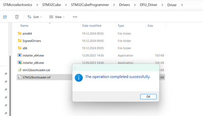

  1. inserted SD card to board, SW1 set to USB, connected PC with CN7
  2. started the STMCubeProgrammer and successfully connected to USB1 (so drivers OK)
  3. downloaded en.FLASH-stm32mp1-openstlinux-6.6-yocto-scarthgap-mpu-v24.11.06.tar.gz and unpacked
  4. run in cmd: C:\Program Files(x86)\STMicroelectronics\STM32Cube\STM32CubeProgrammer\bin>STM32_Programmer_CLI.exe -c port=usb1 -w C:\<path>\FlashLayout_sdcard_stm32mp157f-dk2-optee.tsv
  5. see result Download.png (as I never saw a correct log I think here something went wrong after "Reconnecting the device ...")
  6. on display: "DFU alt info setting: done"
    "crq->brequest: 0x0"
  7. power off, SW1 set to SD card (position oppostite from USB), power ON
  8. nothing on display and on uart
