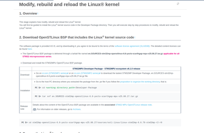

I can’t download the file en.SOURCES-stm32mp-openstlinux-6.6-yocto-scarthgap-mpu-v25.08.27.tar.gz from https://www.st.com/en/embedded-software/stm32mp1dev.html#get-software. Only this file gets downloaded: SDK-x86_64-stm32mp1-openstlinux-6.6-yocto-scarthgap-mpu-v24.11.06.tar.gz.
Could you please advise how I can download the correct en.SOURCES?

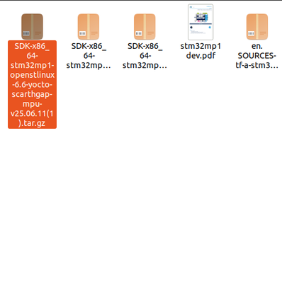

ensol@ensol-IdeaPad-5-15IAL7:~/STM32MPU-Ecosystem-v6.1.0/Developer-Package$ tar xvf en.SOURCES-stm32mp-openstlinux-6.6-yocto-scarthgap-mpu-v25.08.27.tar.gz
tar: en.SOURCES-stm32mp-openstlinux-6.6-yocto-scarthgap-mpu-v25.08.27.tar.gz: Cannot open: No such file or directory
tar: Error is not recoverable: exiting now
ensol@ensol-IdeaPad-5-15IAL7:~/STM32MPU-Ecosystem-v6.1.0/Developer-Package$ ls
SDK  SDK-x86_64-stm32mp1-openstlinux-6.6-yocto-scarthgap-mpu-v25.06.11.tar  stm32mp1-openstlinux-6.6-yocto-scarthgap-mpu-v25.06.11

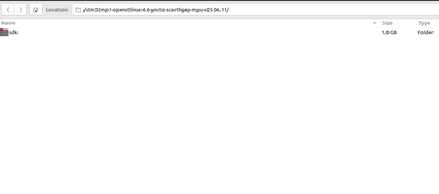

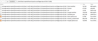

ensol@ensol-IdeaPad-5-15IAL7:~/STM32MPU-Ecosystem-v6.1.0/Developer-Package$ cd stm32mp1-openstlinux-6.6-yocto-scarthgap-mpu-v25.06.11/
ensol@ensol-IdeaPad-5-15IAL7:~/STM32MPU-Ecosystem-v6.1.0/Developer-Package/stm32mp1-openstlinux-6.6-yocto-scarthgap-mpu-v25.06.11$ ls
sdk
At this point I only have the SDK installer under stm32mp1-openstlinux-.../sdk/, and the installed SDK under Developer-Package/SDK. I do not see the OpenSTLinux BSP sources (TF-A/U-Boot/Linux) under the Developer Package directory.
Could you confirm whether en.SOURCES-stm32mp-openstlinux-...tar.gz must be downloaded separately, and if yes, where exactly it should appear and how it should be extracted for the STM32MP1 OpenSTLinux 6.6 scarthgap release?

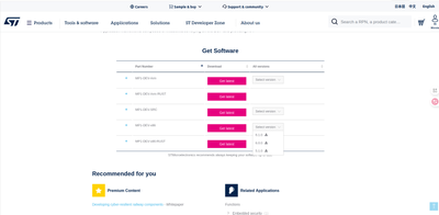

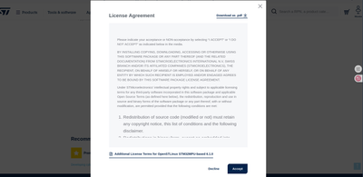

Thank you for your reply. I followed the link and then navigated to st.com (STM32MP1 series), choose 6.1 for x86, but after downloading I did not find an en.SOURCES archive. I’m not sure what I’m doing wrong; could you please advise? Thank you very much.
I’ve attached screenshots below.

Pwxn
You need to download the source now, not the SDK anymore.
Please select MP1-DEV-SRC to download the BSP.
