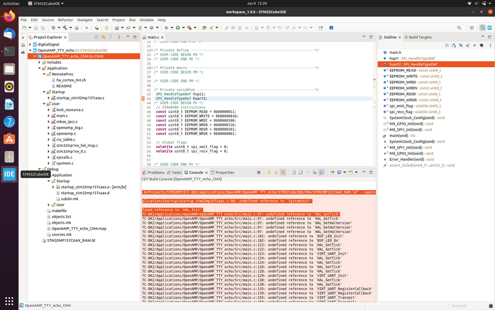

I'm following a tutorial for setting up the STM32MP157C-DK2. I'm on the step for running the OpenAMP_TTY sample program. However, when I try to build the program, I get a whole bunch or errors as follows:
make -j8 all
arm-none-eabi-gcc -o "OpenAMP_TTY_echo_CM4.elf" @"objects.list"   -mcpu=cortex-m4 -T"/home/ben/STM32MPU_workspace/STM32MP15-Ecosystem-v3.1.0/Developer-Package/STM32Cube_FW_MP1_V1.5.0/Projects/STM32MP157C-DK2/Applications/OpenAMP/OpenAMP_TTY_echo/STM32CubeIDE/CM4/STM32MP157CAAX_RAM.ld" --specs=nosys.specs -Wl,-Map="OpenAMP_TTY_echo_CM4.map" -Wl,--gc-sections -static --specs=nano.specs -mfpu=fpv4-sp-d16 -mfloat-abi=hard -mthumb -Wl,--start-group -lc -lm -Wl,--end-group
/usr/lib/gcc/arm-none-eabi/9.2.1/../../../arm-none-eabi/bin/ld: ./Application/Startup/startup_stm32mp157caax.o: in function `LoopFillZerobss':
/home/ben/STM32MPU_workspace/STM32MP15-Ecosystem-v3.1.0/Developer-Package/STM32Cube_FW_MP1_V1.5.0/Projects/STM32MP157C-DK2/Applications/OpenAMP/OpenAMP_TTY_echo/STM32CubeIDE/CM4/Application/Startup/startup_stm32mp157caax.s:90: undefined reference to `SystemInit'
/usr/lib/gcc/arm-none-eabi/9.2.1/../../../arm-none-eabi/bin/ld: ./Application/User/main.o: in function `main':
collect2: error: ld returned 1 exit status
make: *** [makefile:63: OpenAMP_TTY_echo_CM4.elf] Error 1
"make -j8 all" terminated with exit code 2. Build might be incomplete.
I abbreviated the error, but there are 82 of them that say "undefined reference to." I'm thinking that the issue might have something to do with setting the source of the SDK or perhaps with setting up the environment, but I'm not sure. Any help or guidance is greatly appreciated.

Here's the screenshot. I'm using Linux Debian 5.13.0-44-generic
Here's the screenshot. I'm using Linux Debian 5.13.0-44-generic. I'm pretty sure the -j8 and -j3 distinction are references to the number of computing cores used in the make process.

Your problem looks like the project is not able to find the drivers code of your STM32Cube_FW_MP1_V1.5.0.
For example in your traces:
undefined reference to `HAL_GetTick'
This function is normally defined in STM32Cube_FW_MP1_V1.5.0/Drivers/STM32MP1xx_HAL_Driver/Src/stm32mp1xx_hal.c at line 359.
So if your linker is not able to find it, this is because the file was not built during the build.

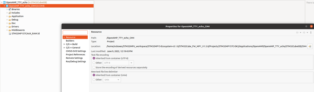

Please can you make a right click then properties on your project "OpenAMP_TTY_echo_CM4", like this:
I would like to see the location of the tty_echo project that you included into cubeIde.
Then please
  • right click again of the project "OpenAMP_TTY_echo_CM4" and "clean Project".
  • build again the project
  • send here the complete build log. (not only the linker).
In your two previous message you only sent the linker traces, but not the one from the build.
Normally they must start we the file.c to build, looks like below:
make -j3 all
arm-none-eabi-gcc "/home/osboxes/STM32MPU_workspace/STM32MP15-Ecosystem-v3.1.0/STM32Cube_FW_MP1_V1.5.0/Middlewares/Third_Party/OpenAMP/virtual_driver/virt_uart.c" -mcpu=cortex-m4 -std=gnu11 -g3 -DMETAL_MAX_DEVICE_REGIONS=2 -DUSE_HAL_DRIVER -DSTM32MP157Cxx -D__LOG_TRACE_IO_ -DCORE_CM4 -DDEBUG -DNO_ATOMIC_64_SUPPORT -DMETAL_INTERNAL -DVIRTIO_SLAVE_ONLY -c -I../../../../../../../../Drivers/STM32MP1xx_HAL_Driver/Inc -I../../../../../../../../Middlewares/Third_Party/OpenAMP/open-amp/lib/include -I../../../../../../../../Drivers/CMSIS/Device/ST/STM32MP1xx/Include -I../../../../../../../../Middlewares/Third_Party/OpenAMP/libmetal/lib/include -I../../../../../../../../Drivers/STM32MP1xx_HAL_Driver/Inc/Legacy -I../../../../../../../../Drivers/BSP/STM32MP15xx_DISCO -I../../../Inc -I../../../../../../../../Drivers/CMSIS/Include -I../../../../../../../../Middlewares/Third_Party/OpenAMP/virtual_driver -O0 -ffunction-sections -fdata-sections -Wall -fstack-usage -MMD -MP -MF"Middlewares/OpenAMP/virtual_driver/virt_uart.d" -MT"Middlewares/OpenAMP/virtual_driver/virt_uart.o" --specs=nano.specs -mfpu=fpv4-sp-d16 -mfloat-abi=hard -mthumb -o "Middlewares/OpenAMP/virtual_driver/virt_uart.o"
arm-none-eabi-gcc "/home/osboxes/STM32MPU_workspace/STM32MP15-Ecosystem-v3.1.0/STM32Cube_FW_MP1_V1.5.0/Middlewares/Third_Party/OpenAMP/open-amp/lib/virtio/virtio.c" -mcpu=cortex-m4 -std=gnu11 -g3 -DMETAL_MAX_DEVICE_REGIONS=2 -DUSE_HAL_DRIVER -DSTM32MP157Cxx -D__LOG_TRACE_IO_ -DCORE_CM4 -DDEBUG -DNO_ATOMIC_64_SUPPORT -DMETAL_INTERNAL -DVIRTIO_SLAVE_ONLY -c -I../../../../../../../../Drivers/STM32MP1xx_HAL_Driver/Inc -I../../../../../../../../Middlewares/Third_Party/OpenAMP/open-amp/lib/include -I../../../../../../../../Drivers/CMSIS/Device/ST/STM32MP1xx/Include -I../../../../../../../../Middlewares/Third_Party/OpenAMP/libmetal/lib/include -I../../../../../../../../Drivers/STM32MP1xx_HAL_Driver/Inc/Legacy -I../../../../../../../../Drivers/BSP/STM32MP15xx_DISCO -I../../../Inc -I../../../../../../../../Drivers/CMSIS/Include -I../../../../../../../../Middlewares/Third_Party/OpenAMP/virtual_driver -O0 -ffunction-sections -fdata-sections -Wall -fstack-usage -MMD -MP -MF"Middlewares/OpenAMP/open-amp/virtio/virtio.d" -MT"Middlewares/OpenAMP/open-amp/virtio/virtio.o" --specs=nano.specs -mfpu=fpv4-sp-d16 -mfloat-abi=hard -mthumb -o "Middlewares/OpenAMP/open-amp/virtio/virtio.o"
It will help me to understand the error that you encounter.
