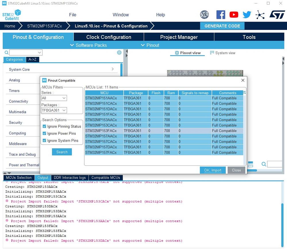

How can I change the target MPU in STM32CubeIDE in an existing project?
  • December 29, 2022
  • 6 replies
  • 3023 views
I'm currently using STM32CubeIDE v1.8.0 on Windows-10
The existing project was targeted for STM32MP157F, because that's the part we had available. I need to generate device tree files for a STM32MP153C, but I don't see any way to change the target MPU in the existing project...

Colorado Russ
December 29, 2022
I attempted to migrate from STM32MP157F to STM32MP153C using the standalone CubeMX tool, but failed because "multiple context"
Output says "Project Import failed: Import 'STM32MP153AACx' not supported (multiple context)
Does "multiple context" mean dual core?

February 5, 2024
Any updates on this? I received the same "multiple context" error when I try to import a project, even when importing a project into the exact same MCU.
February 6, 2024
Sounds like the import functionality is not supported when selecting a dual-core microcontroller in the STM32H7 series (and this might apply to other dual-core systems, too). This info is mentioned on page 16 here, "Import from and to dual-core STM32H7 is not supported."
