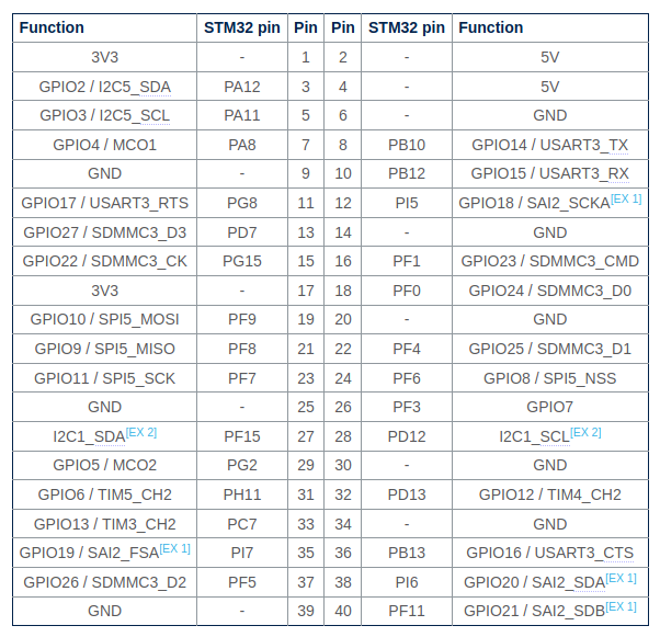

The GPIO pins for the MISO,MOSI and NSS how do i select them for SPI5 ?

but i have a another question in the dtsi i wrote spi5 segment like this:
&spi5 {
	pinctrl-names = "default", "sleep";
	pinctrl-0 = <&spi5_pins_a>;
	pinctrl-1 = <&spi5_sleep_pins_a>;
	cs-gpios = <&gpioz 3 0>;
	status = "okay";
	/* USER CODE BEGIN spi5 */
	spidev@0{
	        compatible = "spidev";
	        reg = <0>;  /* CS #0 */
	        spi-max-frequency = <1800000>;
my question is the gpios. this line "cs-gpios = <&gpioz 3 0>;" appears wrong to me because in the example these are for spi4 i guess but i need to use spi5 in wiki i found this:
https://wiki.st.com/stm32mpu/wiki/STM32MP157x-DKx_-_hardware_description#GPIO_expansion_connector
0693W000006Fxr3QAC.pngwhich pins should write in to "cs-gpios = <&gpioz 3 0>;" this function can figure it out; my guess is "cs-gpios= <&gpiof 6 0>" but im not sure
