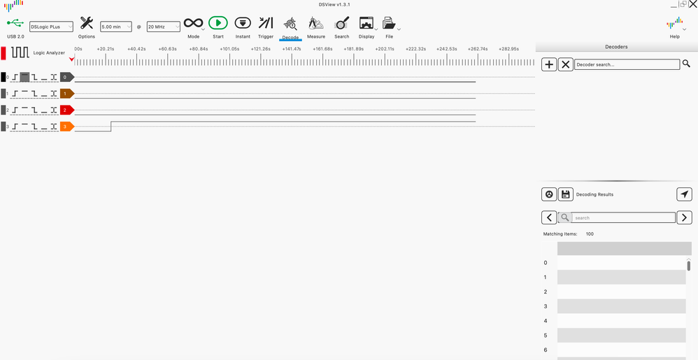

My goal is highly consistent with this ticket:
https://community.st.com/t5/stm32-mpus-products/cannot-get-spi-lcd-working-with-stm32mp157d-dk1-yocto/m-p/225522
I hope to drive the LCD ili9341 based on STM32MP157F-DK2 but till now it has not been successful, the LCD has always been a white screen.
kernel config
CONFIG_TINYDRM_ILI9341=y
/* drivers/gpu/drm/tiny/ili9341.c */
device tree
&spi5 {
	status = "okay";
	panel: display@0{
		compatible = "adafruit,yx240qv29", "ilitek,ili9341";
		reg = <0>;
		spi-3wire;
		spi-max-frequency = <10000000>;
		dc-gpios = <&gpioa 8 GPIO_ACTIVE_HIGH>;
		reset-gpios = <&gpiod 7 GPIO_ACTIVE_HIGH>;
		rotation = <270>;
		status = "okay";

waveform
I observed four signals:SCLK/MOSI/DC/RESET.(the CS is by default connected to gnd.
but there is no action on SPI.
I suspect there is still something wrong with the configuration of the device tree, but I don't know how to configure it.
Did you make any progress later? can you share with me?Thanks a lot.

The following is the wave, the channel 3 is the RESET signal:
