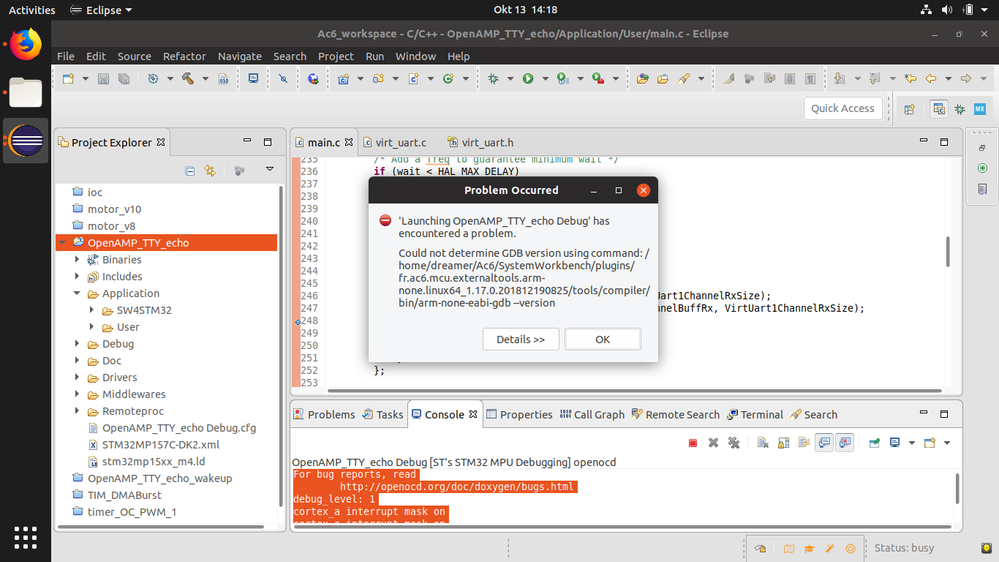

I am trying to debug my M4 program on systemworkbench (eclipse) for the board stm32mp157c-dk2 and the host computer is ubuntu. I have set breakpoints in normal flow and also in exceptional flows in the program. Program works very well in debug and I can see the outputs via my qt program on linux side on mini display. But the flow never stops by breakpoints. The breakpoints have no effect. I am doing the following steps correctly. Please tell me what is missing or what I am doing false...
- build the project in eclipse
- select production mode in debug configuration because the program is based on the example "OpenAMP_TTY_echo"
- give the ip address in debug configuration
- right click on project and select Debug As --> ST's STM32 MPU C/C++ Application
And this is the log on console when the debug starts

And the pop up which is coming and that I dont think it is a serious problem (not sure) is here:

Hi @IYetk​
Pop up error is a serious problem.
May I recommend to attempt a reinstallation of SW4STM32 ?
Else we are announcing STM32CubeIDE V1.1.0 which is now the new reference eclipse IDE for STM32MP1 and is about to be available on st.com
Refer to new MP1 Ecosystem Release note:
https://wiki.st.com/stm32mpu/index.php/STM32MP15_ecosystem_release_note_-_v1.1.0
Hope it help

‎2019-10-15 2:26 AM
OK i see.
I think I will work with STM32CubeIDE V1.1.0
