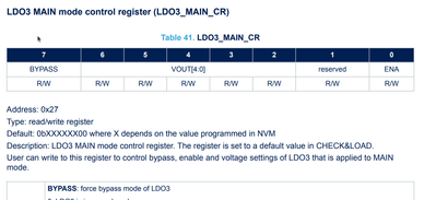

We also observed that the STM32MP157F-DK2 send commands to the 0x27 register, which sets the voltage levels for the LDO3 (This LDO is connected to the VREF_DDR node, which is the reference voltage for the RAM).
