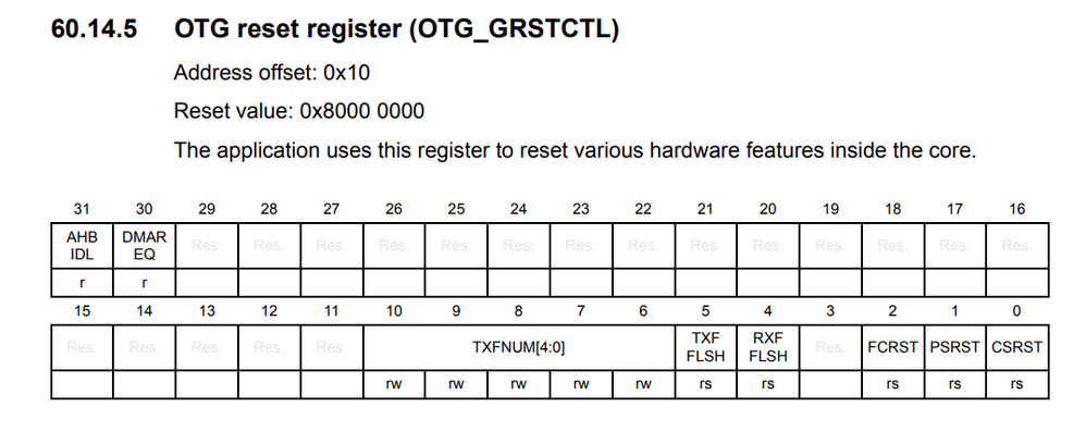

I am trying to use the USB OTG in host mode, but it kept giving me the famous HANG! Soft Reset timeout GRSTCTL_CSFTRST error.
According to the datasheet, when we set the register, it should reset the core but also clear itself but the following condition checks if it is 0 or not.

0693W00000YAVpzQAH.pngHere is some debugging that I have done
GRSTCTL VALUE before reset: 0x80000400
GRSTCTL VALUE after reset: 0x80000401
GRSTCTL inside if condition: 0x80000001
Here you can see, it has even cleared the 10th bit itself but did not clear the bit 0.
