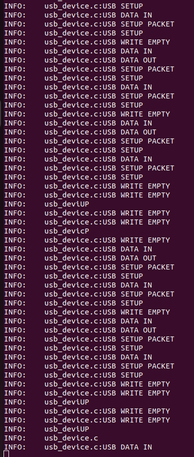

I'm getting these errors on the consoles when FSBL (TF-A) is trying to download SSBL (U-Boot). What could this DFU error be? I've added the following to the U-Boot DTSI file so it ignore USB OTG VBUS and USB OTG ID. I've tried this using Linux and Windows with STProgrammer.

Is there not a version of this for TF-A? It almost seems like it's waiting for something to happen on the USB/DFU side but it never does. Eventually just times out. Custom target does not use USB OTG VBUS or USB OTG ID.

So I tried adding the following to the TF-A DTS
&usbotg_hs{
	pinctrl-names = "default";
	pinctrl-0 = <&usb_otg_hs_pins_mx>;
	status = "okay";
	/* USER CODE BEGIN usbotg_hs */
	/*compatible = "st,stm32mp15-hsotg", "snps,dwc2";		/* 0: UTMI switch selects the OTG controller */
	/*phys = <&usbphyc_port1 0>;
	/*phy-names = "usb2-phy";								/* could be "host", see USB generic bindings */
	dr_mode = "peripheral";								/* see USB generic bindings */
	usb-role-switch;									/* could be "host", see USB generic bindings */
	role-switch-default-mode = "peripheral";			/* enable OTG */
	/* USER CODE END usbotg_hs */
I tried with/without the compatibility and the phy entries. Same result. On the console TF-A is waiting on something to happen over USB it seems. I've added prints to the USB area in TF-A and it repeatedly tries to get started but never does. Sometimes it'll show on the programmer side stage 2 indicating it's going to download the optee bin file but never gets started. Seems to have gotten a little more difficult to track down in source code what's happening so a bit of a challenge to debug.
