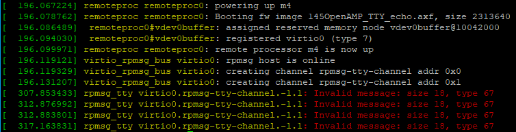

I am trying to establish an interprocessor communication between the cores A7 and M4 with the with the Stm32MP157.
The example from ST "OpenAMP_TTY_echo" works fine, but as soon as I change the received buffer or try to send a costomize buffer from the M4 side, it is not received correctly by the A7 anymore.
0693W00000Y9x2yQAB.pngThis error happens even if I change only one character in the receive buffer.
Does anyone have a clue what is going wrong?

HI @JJemm.1​ ,
The firmware package 1.4 looks quite old for me. You have to be sure that you are aligned with your OSTL version !
For example, if you work with OSTL 4.1 (or 4.0 anyway, = Linux 5.15), you must use the Cube FW Package v1.6 ! It is mandatory to have the 2 versions aligned because there is some dependencies for Coprocessor communication between both.

Hello @JJemm.1​ ,
Indeed, your issue looks really strange.
Can you share with me the M4 firmware code that you have modified to get this error ? I think something is going wrong somewhere with the modifications.

Hallo @ Erwan SZYMANSKI,
thank you for the reply. This was also my first thought, but I think that is not the case. As I have tried many variations and all have resulted in a similar error.
The screenshot I posted was made with the sample code from STM32CubeMP1 FW Package v1.4.0 (https://github.com/STMicroelectronics/STM32CubeMP1/releases/tag/1.4.0 ) which I modified according to the description ( 9 Modify the firmware: https://wiki.st.com/stm32mpu/wiki/Getting_started/STM32MP1_boards/STM32MP157x-EV1/Develop_on_Arm®_Cortex®-M4/Modify,_rebuild_and_reload_a_firmware ).
I also tried the example from STM32CubeMP1 FW Package v1.6.0 and STM32CubeMP1 FW Package v1.2.0. With 1.6 no Rx callback was started and with 1.2 the Rx callback was started but no log_info(...) texts were output. With 1.4 both worked, so I continued with this version.
I can imagine that it is a driver problem but I cannot explain what exactly is wrong.

JJemm.1
Hi @Erwan SZYMANSKI,
Thanks for the quick reply,
I have managed it in the meantime. It was a version problem as you assumed, but I'm not using the OSTL but a vendor YOCTO project . However, with the kernel version 5.10.74 I had the above-mentioned misbehaviour with 5.10.153 it seems to work even with the FW Package 1.6.
