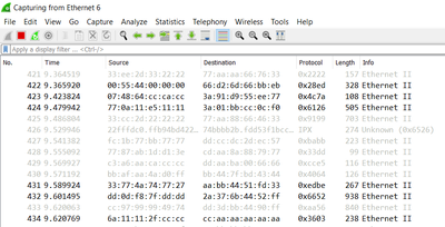

After enabling the clock, eth2 wakes up. In wireshark, I can see data being transferred and the interface's LED blink. The thing is, the visible data is an uncontrolled spam of bytes that does not stop.

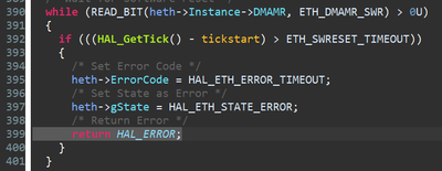

I am also getting an error in this section of code:
The SWR bit is always 1, so the eth2 can't be reset.

I have managed to make some progress.
My clock was configured to 50 MHz, but after reading the frequency with an oscilloscope it was exactly more than 51 MHz. After configuring PLL4 to work with HSE instead of HSI, there is no byte spam anymore.
At the end, it didn't solve my problem. I am still receiving an error:
I think there is something wrong with rcc and syscfg.

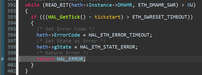

10. Now it will hang in HAL_StatusTypeDef HAL_ETH_Init(ETH_HandleTypeDef *heth)
stm32mp13xx_hal_eth.c
/* Wait for software reset */
while (READ_BIT(heth->Instance->DMAMR, ETH_DMAMR_SWR) > 0U)
if (((HAL_GetTick() - tickstart) > ETH_SWRESET_TIMEOUT))
/* Set Error Code */
heth->ErrorCode = HAL_ETH_ERROR_TIMEOUT;
/* Set State as Error */
heth->gState = HAL_ETH_STATE_ERROR;
/* Return Error */
printf("6 ERROR."); // I just put info to UART terminal
return HAL_ERROR;

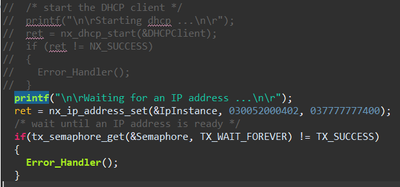

Added later:
Comment out the DHCP section of code and set your ip manually in IPInstance. Changing the IP will call a Callback function which unlocks the Semaphore.
I also tried to start with STATIC ADDRESS and disable all DHCP inititializationprior to write this comment, for ETH1 it is working correctly
ret = nx_ip_create(&IpInstance, "Main Ip instance", STATIC_ADDRESS, MASK_ADDRESS, &AppPool, nx_stm32_eth_driver,
but for ETH2 when I do this it will pass all initialization but after I tried to get IP number it will get 0.0.0.0.
nx_ip_address_get(&IpInstance, &IpAddress, &NetMask);
/* print the IP address */
PRINT_IP_ADDRESS(IpAddress);
For ETH1 I get IpAddress as STATIC_ADDRESS.
