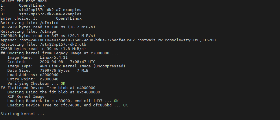

SPL+UBOOT to boot the kernel. uboot version is 2020.01
User.44
The kernel cannot be started in a loop, as long as I use TF-A+UBOOT to start the kernel

Can you please further clarify your context.
I understand you are using V2.0 ecosystem version.
Using Uboot SPL ( aka Basic boot no more supported ) or TFA+Uboot ( trusted boot ) ?
Did you use Distribution or Developper package to build your image ?
What customization did you do from default provided sources ?
Which HW ? ST board or custom ?
Thx
Olivier
Olivier GALLIEN
User.44
I am in the uboot code. Use the configuration file stm32mp15_basic_defconfig. Compile SPL and uboot. Then replace flashing to SD card to start, the following situation will appear
0693W000005AC5iQAG.pngStuck here, will not boot the kernel
STM32MP157C-DK2

Hi @文�?� �?​
From ecosystem V2.0, "basic boot" is no longer supported. Uboot SPL can no longer boot the kernel.
Cf https://wiki.st.com/stm32mpu/wiki/STM32MP15_ecosystem_release_note_-_v2.0.0
You have to switch to Trusted boot chain.
Olivier
