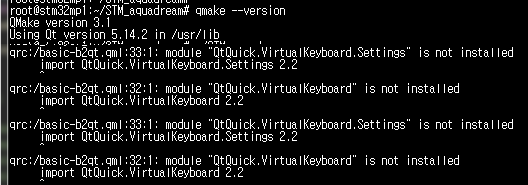

qt5 virtual keyboard error What should I do?

Hello @WSung.2​ ,
If you are using the Distribution package to generate your image, you can ask Yocto to take other recipes to install. This is the case for the Virtual Keyboard.
For example, in a local.conf, you can have this:
IMAGE_INSTALL_append = " \
qtcharts \
qtsvg \
qtvirtualkeyboard \
qtlocation \
qtquickcontrols2 \
qtquickcontrols \
Here you can see that for my Qt application, I need to add more Qt libs, and the Virtual Keyboard is included.
Kind regards.
Erwan.

@WSung.2​ ,
Excuse me, the IMAGE_INSTALL_append that I put was a personal example, you do not have "boot2qt" and that is logical. Just remove it.
In fact, if virtualkey board is the only lib that miss, you can only put this one.
Moreover, if you want to make a big qt application, I advice you to use EGLFS instead of qtwayland, because of perfs. You can find information on this wiki page : https://wiki.st.com/stm32mpu/wiki/How_to_build_and_use_an_SDK_for_QT
Regards.
Erwan.
