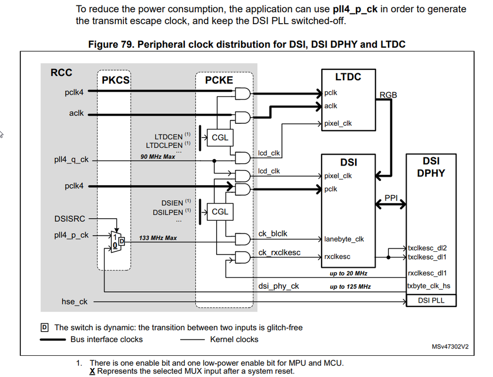

By looking at the refman RM0436.pdf v5.0 page 572:
0693W00000LyimIQAR.pngWe can see that the pclk is pclk4.
So I don't know why pclk4 is not available with your board.
