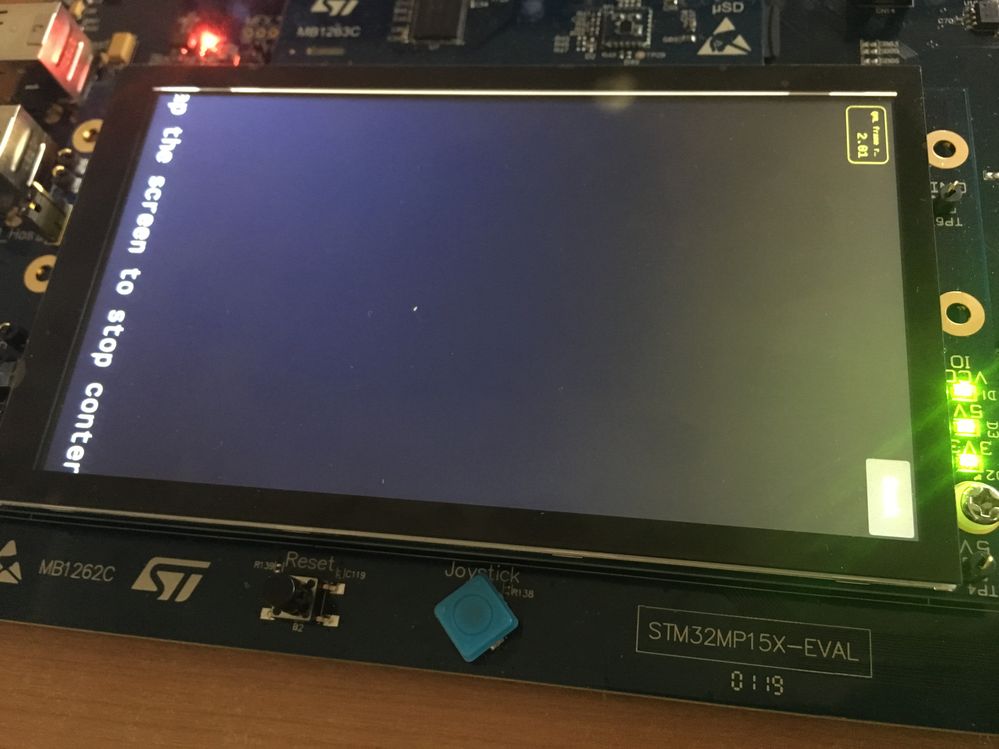

gokhannsahin
This example can't play the video. A black screen always seems. I attached a screen of it.
Is it possible to use wayland with qt for your example distros?(if choose openstlinux-weston)
Or which is better performance while playing a video?
EDIT:
It was solved after installed qt to /opt/ path.
