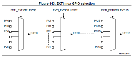

maybe an explanation is the way the EXTI HW allows to connect to pins.
Only one EXTI channel N interrupt could be define for each PxN port.
e.g. in your case, you might have another interrupt in conflict with PE1. Could be PA1, PB1, etc....
See https://wiki.st.com/stm32mpu/wiki/EXTI_internal_peripheral#Peripheral_overview and EXTI section in product RefMan.
0693W00000FB0DbQAL.pngRegards.
