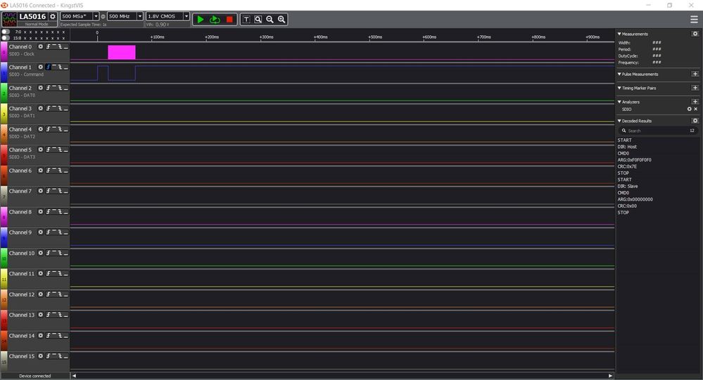

Dear community,
we got a problem booting from our eMMC (THGBMJG9C8LBAU8) memory and we cannot figure out how to solve it.
The Silicon Revision seem to be "Z". Attached you can the the ping pong between MPU (STM32MP151A) and eMMC. The initialization sequence is coming from the MPU and the eMMC also responds. But after that there is no follow-up. We have looked up the errata sheet (Link 2.3.8) and it seems there were problems with older silicon revisions but we are wondering if the issue still occurs with Z revision as the described behavior in the errata is very similar.
Attached you can find the command sequence observed by the logic analyzer and the BootRom Log.
Thanks,
Bernhard

PatrickF
March 3, 2021
I assume the eMMC was flashed using STM32CubeProgrammer without issues. Do you confirm ?
Did you use standard pins for eMMC boot (PE3 = CLK, PG6 = CMD, PB14 = DAT0) ? see AN5031.
In your plot, I see DAT0 is always low, whereas it should be high (missing pull-up ? bad probing ?).
You must see the following sequence (eMMC JEDEC Standard No. 84-B51)
  1. clock is established (approx. 16MHz in case of STM32MP1 boot)
  2. few toggling from STM32MP1 on CMD line (GO_PRE_IDLE_STATE command  = CMD0 + 0xF0F0F0F0F0)
  3. after few us, the STM32MP1 will force CMD low (this is the eMMC boot request)
  4. then within 50ms, the eMMC should respond on DAT0 with an ACK (Start bit + 010 + End bit)
  5. then within 1second, the eMMC should provide boot partition data on DAT0.
Here, the STM32MP1 BootROM exit on timeout on point 4) as there is no ACK from eMMC.
The issue you mention in the Errata is corrected on Rev.Z
Regards.

Hi Patrick,
yes, we use the standard pins and yes we do not get the ACK on our side. We have found a hardware issue causing this and we are working on a fix. After this it should work fine.
