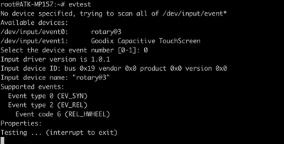

I'm doing a project, that I need a rotary encoder working on cortex-a7 core of stm32mp157.
I met problem, my rotary encoder can not work.
This is what I have done:
1. In kernel menuconfig I have config: use rotary encoder as a build-in module;
2. Write dts, and I am sure these gpio not been use anywhere:
    rotary@3 {
        compatible = "rotary-encoder";
        gpios = <&gpioa 0 GPIO_ACTIVE_LOW>, <&gpiog 3 GPIO_ACTIVE_LOW>;
        linux,axis = <6>;
        rotary-encoder,encoding = "gray";
        rotary-encoder,relative-axis;
        status = "okay";
In dmesg I can see my roary is started
In /proc/device-tree, I can see the device node
In evtest nothing output, when I turn the knob of encoder.
what is the problem, I need your help, thank you!

PatrickF
HI @Jason007
Did you have GPIOs pull-ups on the board ?
Maybe try if internal pull-up is ok by using
(GPIO_ACTIVE_LOW | GPIO_PULL_UP)
Alternatively (could reach higher count rate), you could use TIM or LPTIM for this (still need pull-ups).
See https://wiki.stmicroelectronics.cn/stm32mpu/wiki/How_to_use_the_IIO_user_space_interface#How_to_use_the_quadrature_encoder_with_the_sysfs_interface
(need to chose input pins according to Timers inputs possible muxing).
