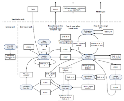

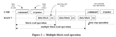

as per eMMC or SD-Card standard, the CMD line is mandatory as this line convey all the command and status to/from the card (e.g. initial negotiation of operating voltage and mode, request read, write, select block, erase, etc...).
All the protocol is using CMD line everytime.
e.g. eMMC read
There is state machine defined in the standard which must be followed by the SW.
e.g. for eMMC.
I think for HW SDMMC IP, there is no way to bypass this way of working. At least we cannot provide any support for this very specific case.
Maybe worth to look another interface more suitable to your needs (or uses CMD line as required).
