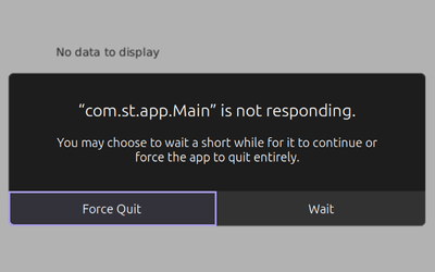

0xedbea4
No, the TYPEC error doesn't look to be terminal...  I can CTRL-C out of DFU mode on the device...
https://community.st.com/t5/stm32-mpus-embedded-software-and/dwc2-udc-otg-usb-otg-49000000-no-uclass-usb-typec-for-remote/td-p/728810
STM32CubeProgrammer does completely crash while trying to connect however...
I'll try the commandline
0xedbea4
Basically the same behaviour with STM32CubeProgrammer_CLI, but it times out gracefully.
Quirky that adding the OTG node doesn't reflect much in the uboot usb commands, but DFU does start....

And there's definitely a lower level error after uboot enters DFU
From hostmachine:
[19987.379768] usb 1-7: new high-speed USB device number 49 using xhci_hcd
[19992.795668] usb 1-7: device descriptor read/64, error -110
5 volts on the USB is not connected between my host machine and the target?
