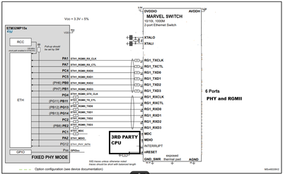

We have a Custom Board based from MB1272 dev kit.
Our system needs to connect the RGMII to a Marvell Switch Chip where that Switch is Managed MDIO from a different MPU.
As such we need our STM32MP157 MPU to run in a fixed phy mode and use the RCC to be its 125Mhz clk.
Please see simplified drawing
I have looked at the https://wiki.st.com/stm32mpu/wiki/Ethernet_device_tree_configuration#RGMII_with_Crystal_on_PHY-2C_no_125Mhz_from_PHY
but still confused as to how to do this
We have tried a few DT settings but  no success,
would really appreciate some help on this one
Thanks

trying to help, maybe share more details of what's going wrong.
Any dmesg on the console to share ?
You should also define the 125MHz clock path in the DT.
https://wiki.st.com/stm32mpu/wiki/Clock_overview
Regards,

Hi PatrickF
Below
1. clk_summary attached.
2. dmesg:
[  169.674938] stm32f7-i2c 40015000.i2c: Trying to recover bus
 grep mac
[    3.478063] stm32-dwmac 5800a000.ethernet: IRQ eth_lpi not found
[    3.483170] stm32-dwmac 5800a000.ethernet: no reset control found
[    3.489619] stm32-dwmac 5800a000.ethernet: User ID: 0x40, Synopsys ID: 0x42
[    3.495788] stm32-dwmac 5800a000.ethernet:   DWMAC4/5
[    3.500782] stm32-dwmac 5800a000.ethernet: DMA HW capability register supported
[    3.508069] stm32-dwmac 5800a000.ethernet: RX Checksum Offload Engine supported
[    3.515380] stm32-dwmac 5800a000.ethernet: TX Checksum insertion supported
[    3.522294] stm32-dwmac 5800a000.ethernet: Wake-Up On Lan supported
[    3.528613] stm32-dwmac 5800a000.ethernet: TSO supported
[    3.533818] stm32-dwmac 5800a000.ethernet: Enable RX Mitigation via HW Watchdog Timer
[    3.541755] stm32-dwmac 5800a000.ethernet: device MAC address fa:5c:95:0f:a0:f5
[    3.548946] stm32-dwmac 5800a000.ethernet: Enabled Flow TC (entries=2)
[    3.555553] stm32-dwmac 5800a000.ethernet: TSO feature enabled
[    3.561346] stm32-dwmac 5800a000.ethernet: Using 32 bits DMA width
[   14.580959] stm32-dwmac 5800a000.ethernet: Failed to reset the dma
[   14.585759] stm32-dwmac 5800a000.ethernet eth0: stmmac_hw_setup: DMA engine initialization failed
[   14.594789] stm32-dwmac 5800a000.ethernet eth0: stmmac_open: Hw setup failed
3. dts attached
