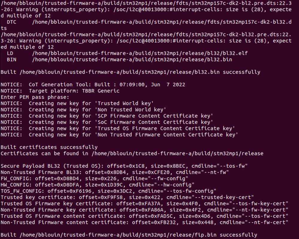

  1. Build TF-A
make CROSS_COMPILE=arm-none-eabi- PLAT=stm32mp1 ARCH=aarch32 ARM_ARCH_MAJOR=7 AARCH32_SP=sp_min BL33=$HOME/u-boot/u-boot-nodtb.bin BL33_CFG=$HOME/u-boot/u-boot.dtb DTB_FILE_NAME=stm32mp157f-dk2 TRUSTED_BOARD_BOOT=1 GENERATE_COT=1 ROT_KEY=$HOME/keys/privateKey.pem fip
ERROR
When I build with the command above it finishes but references the 157C-dk2 during BL2 building.

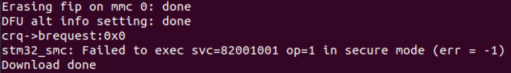

0693W00000NrKHKQA3.pngWhen I build with the STM32MP_SDMMC=1 I get the following DFU boot error.

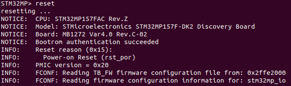

0693W00000NrKIhQAN.pngWhen I flash I get this error in U-Boot DFU mode using the FIP without the SDMMC code I get an error
can not erease FIP

OlivierK
Hi bblouin (Community Member),
For the Build TF-A you need to specify the DTB file name:
DTB_FILE_NAME=stm32mp157f-dk2.dtb
https://wiki.st.com/stm32mpu/wiki/How_to_configure_TF-A_SP-MIN
Also, you'd better source the SDK environment so that your cross compile variable will be set
$ echo $CROSS_COMPILE
arm-ostl-linux-gnueabi-
https://wiki.st.com/stm32mpu/wiki/STM32MP1_Developer_Package#Installing_the_SDK
Regards,
Olivier
