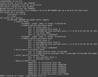

Running the iio_info command on a terminal into a STM32MP157F-DK2 (booting from the shipped SD-card) reports some errors:
root@stm32mp1:~# iio_info
Library version: 0.23 (git tag: 92d6a35)
Compiled with backends: local xml ip usb serial
IIO context created with local backend.
Backend version: 0.23 (git tag: 92d6a35)
Backend description string: Linux stm32mp1 5.15.45 #1 SMP PREEMPT Mon Jun 6 06:43:42 UTC 2022 armv7l
IIO context has 2 attributes:
local,kernel: 5.15.45
uri: local:
IIO context has 2 devices:
iio:device0: 48003000.adc:adc@0 (buffer capable)
2 channels found:
ERROR: checking for trigger : Input/output error (5)
iio:device1: 48003000.adc:adc@100 (buffer capable)
4 channels found:
(Several dozen lines dropped here. And trying to format the output as 'code' throws HTML errors).
What do these trigger - related errors tell me?

Hi @Ozone
could you try to select choice 2 during boot (not easy to catch I agree)
Select the boot mode
1:      OpenSTLinux
2:      stm32mp157f-dk2-a7-examples
3:      stm32mp157f-dk2-m4-examples
Enter choice: 2
 then iio_info seems not giving errors.
Regards.

Well, at least better ...
I haven't kept the full command output from the first post, to be honest.
Having switched to "stm32mp157f-dk2-a7-examples", I get this output from iio_info. (This time the full output, just to be complete):

Here the output for channel 0 again as screenshot, with nicer formatting:
While the "input/output error (5)" seems to persist, there are trigger attributes listed now which haven't been there before.
Which is fine for me right now, so I will mark this thread as "solved". Perhaps I come back to this topic later.
